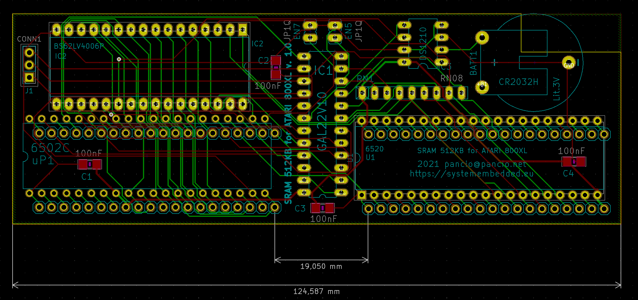

A few years ago I designed PCB for Atari 65/130XE based on HIAS 512KB SRAM project. Some colleagues asked me about version for Atari 800XL with FREDDIE. Today I added data regarding A800XLF version to article:
https://systemembedded.eu/viewtopic.php?f=28&t=40&p=49#p49
It's very easy to assembly and run. Personally I'm using this mod in my two 65XE without any issues. This is not tested yet because I'm waiting for first part of PCB. Of course anyone might collaborate - I'm open for any suggestion for changes 🙂
Have fun!

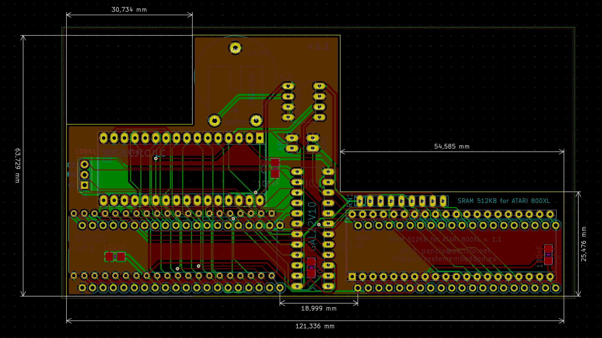

Some users which using PokeyMAX or Dual Pokey Mod, might have an issue to place SRAM module because of PCB dimensions. Yesterday, together with SuN we're rebuilder PCB design to avoid this inconvenience...
now we have much more space under PIA chip and other mod might me installed without any issue.

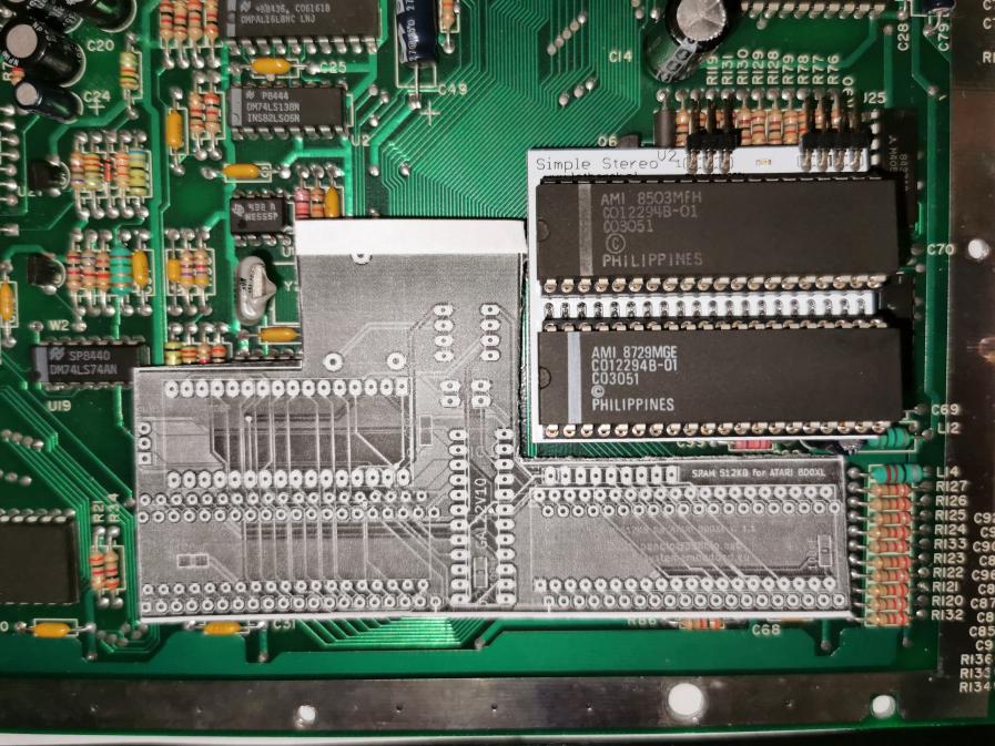

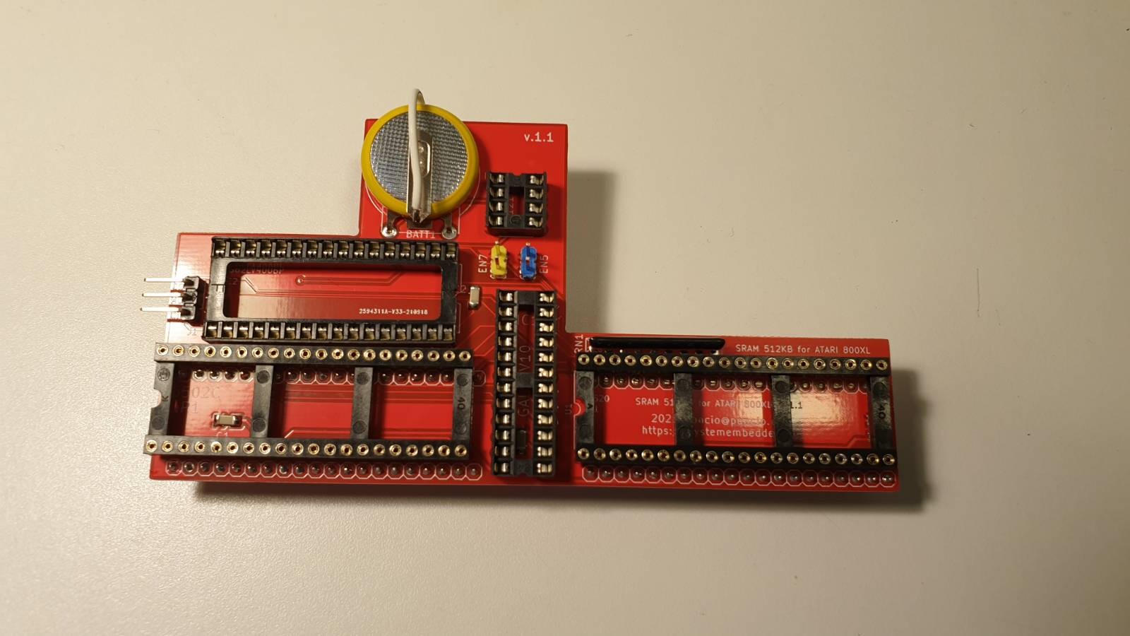

SRAM 512K with battery backup for Atari 800 XLF is pretty ready to use... now I'm looking for candidate for upgrade 🙂
I have an Original 800 XL with Freddie (PAL) with No RAM Extension and would Like to Test the board. Ist ist possible to geht one? It could be a naked one without parts. I have the parts and skills to solder.
Hello Olix,
Sure, it's possible. I've a few PCBs which I may sell. Today I run one module with 800XL without Freddie (yes, it's possible too - I didn't realize about it) I may summary with a few sentence:
- only 320KB is visible at this moment. I checked banks using MEMTEST v1.0. Seems like no 7bit is using. It will be investigated.
- there is no possible to close top case if you are using sockets under main chips (CPU, PIA and GAL).
- SELFTEST can check only 24KB and starting again
So at this moment it's not ready for use at all or my stock Atari 800 XL is broken (e.g. PIA or stock RAM).
